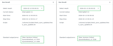

-eunits=<eunit-model> option, stops all apps installed on a volume in the specified expansion unit model, or depend on apps installed on a volume in the specified expansion unit model.I'm also considering preventing packages from auto updating (for '25+ models):

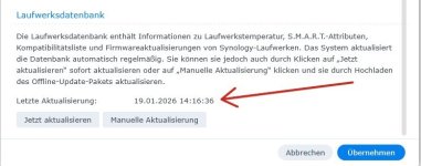

Ist als zweites Script im Zip File dabei, syno_hdd_shutdown.sh@DaveR is this already implemented in v3.6.122?
A few days ago 2025-02-12, Synology apparently renewed the database.
