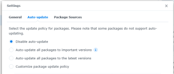

@ctrlaltdelete You have DSM updates set to notify. Did you get a notified and then click update or did DSM update itself?
Did you also have packages set to notify (auto-update disabled)?

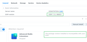

In my videostation_for_722 script it changes the first part of the version number. It changes Advanced Media Codecs version 3.0.1-2004 to 30.0.1-2004 which worked fine in DSM 7.2.2. But DSM 7.3.1 knows it's incompatible. Which is why I was thinking of changing the build number in the companion script. Or I could even get the latest package version number from Synology's website and make the currently installed version appear like the latest version. Then syno_hdd_db would restore the package's original version number (from the companion script's log) after the volume was back online.

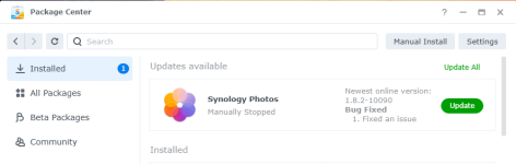

On the DS925+ I had Synology Photos stopped and it did not get updated when I updated to DSM 7.3.1 Update 1. But it's installed on a HDD volume so DSM did not try to "repair" it.
Yes, it's disabled

Synology Photos survived and di not automatically update or repair.

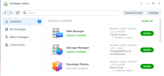

Auf der 224+ und der 1019+ gerade problemlos durchgelaufen. Vorher waren einige Pakete zum Update bereit. Was mir in dem Zusammenhang auffällt: Seit einiger Zeit werden mir Updates von Paketen angeboten (z.B. Synology Office), die ich gar nicht installiert habe.
