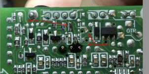

I'm including photos here, for ease of reference, for others looking for this in the future.
Note: this is actually faster and easier to do than doing the other adjustment, and as I can read from the schematics, there is very low risk in voltage problems..
As I read it, it is safer changing the power supply from 3.9k -> 10k, because it effectively drops the total possible voltage load to the sensor circuit (and doesn't harm other feeds).
Of course with all of this, it's quite easy to cause a calamity if the user damages/shorts while making the mod, so please don't attempt this if you are not dead 100% certain you have proper tools and know what you're doing.
I would begin by being certain your Power supply has been fully discharged. fortunately for this unit, it had been running, and mains were disconnected, effectively bleeding off remaining voltage (though this may not always be the situation)..
We only replaced the 3.9k with a 10.0 k resistor. and of course left the 3.9k "parked" on the board, in case someone finds it in 2044 and then we will have them baffled... ;)
So, many thanks, Tom. This has helped us tremendously.

your PSU is not usual / original for the DS1515+ and DS1815+
Thats a newer Model and had been changed already.

yes, this PSU has jumpers and is alternate variant.
I actually had several Delta PSUs here for this, and most of them look nearly identical to the photos i provided. I suspect this is the newer version..

I am from New Zealand, I saw the fix in the image below and applied it and everything was fine for 6 weeks, should I undo this and apply the fix on page 7-8 please?

I guess I need to replace the resistor on the power board, is this easy to get to? I can't see from the pics on page 7-8?

Your pic above showes a DS1815+ (?), sure is a DS1515+ since there is instead of Q4 then Q2. If you look at post #149 there is to change Q2 and in addition including of Q1 is needed.
TN-Notebooks
30. Mai 2019
234
193
93
DS1515+ and DS1815+ are different.
Remove resistor at the transistor.
Change 1 transistor. Install 10k in psu and the 100 ohm for the c2000 bug
