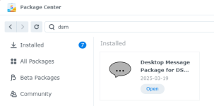

I never got around to finishing https://github.com/007revad/ScriptNotify so it's still currently incomplete. When finished it would only send messages to the DSM Notifications, like:
So no email notifications.
I'm sorry. You got me wrong. :)
I want to create a DSM notifcation or send an eMail notification from a bash script. Maybe finally both methods to send a notification make sense. But then I just have to use @Tommes snippet and your code. But I frankly don't understand how I have to invoke your code to create a DSM notification from a bash script :( Do you have any code snippet handy?
My ScriptNotify is not finished. When it is finished there will be Release with a ScriptNotify_1.0.0-0001.spk file to install in package center. For ScriptNotify I think I started with Horst Schimd's DemoUiSpk7 or @Tommes DSM7DemoSPK and stripped out all the parts I didn't need.
During installation of the attached earlier test spk file you get the option to set up to 10 titles and messages. Which will give you:
Then to send a message to DSM with title02 and msgA you would use the following in your script:
synodsmnotify -c SYNO.SDS._ThirdParty.App.DskMsg @users DskMsg:DskMsg1:title02 DskMsg:DskMsg1:msgA
which would result in a DSM notification containing:
Reaktionen: framp und Benie
