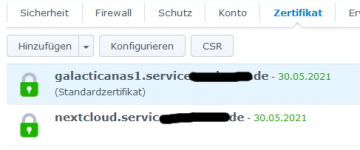

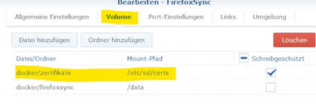

syncserver.ini:
[server:main]
use = egg:gunicorn
host = 0.0.0.0
port = 5000
workers = 1
timeout = 30
keyfile = /etc/ssl/certs/privatekey.pem
certfile = /etc/ssl/certs/certificate.pem
ssl_version = 5
forwarded_allow_ips = *
#debug = True
#accesslog = -
errorlog = -
loglevel = warning
[app:main]
use = egg:syncserver
[syncserver]
public_url = https://sub.mydomain.tld:32777
sqluri = sqlite:////data/syncserver.db
secret = irgendwasschrecklichgeheimes
allow_new_users = false
# force_wsgi_environ = true
Einstellung Container:
certificate.pem
-----BEGIN CERTIFICATE-----
  ... eigenes Zertifikat ...
-----END CERTIFICATE-----
  ... Brückenzertifikat ...
Einstellung in Firefox beta (Android):
Benutzerdefinierter Sync-Server: https://sub.mydomain.tld:32777/token/1.0/sync/1.5
Damit sollte es klappen.
