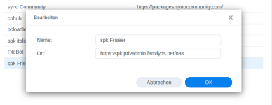

hmm, via copy paste aus #9 immer noch:

That screenshot was from my 3rd or 4th attempt. I tried:
I just noticed it works on some of Synology NAS but not others.
  • DS1821+ works (DSM 7.3.1).
  • DS925+ works (DSM 7.3.2).
  • DS1812+ works but non DSM 6 package (DSM 6.2.4).
  • DS720+ invalid location (DSM 7.2.2 Update 3).
  • DS218 invalid location (DSM 7.3.2 Update 2)).
I'm rebooting the DS218 to see if that fixes it.
EDIT Same error after a reboot.
I´m on DS218+, DSM 7.3.2-86009 Update 3...
dito DS18+DSM 7.3.2-86009 Update 3, - gleiches Ergebnis wie in Post #11
