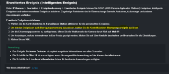

Was genau bedeuten denn die Haken bei "Enable on Surveillance Station" in den Advanced Event Settings? In der Online Hilfe heisst es nur:
Advanced Event (Smart Event)​
In IP Camera > Edit > Event Detection > Advanced Event, you can enable ACAP (AXIS Camera Application Platform) events, Smart Events, and other advanced events. Related functions will be available in Monitor Center, Recording, Action Rule, and other applications.
To enable advanced events:​
  1. Select the Enable on Surveillance Station checkboxes for the desired events.
  2. To trigger motion detection along with the events, select the Trigger Motion Event checkboxes.
  3. To configure the detection parameters, click Web UI to open the settings page.
  4. To determine what information to show on live feeds, click Edit Live View and modify settings.
  5. Click OK."
Ich verstehe das so, dass in meiner Config einfach nur ein "Advanced Event" geloggt wird, auf welches ich dann reagieren KÖNNTE.
