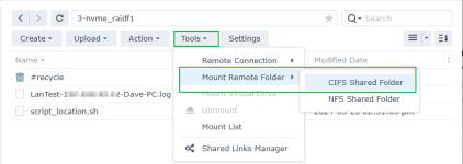

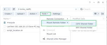

I have previously created hardlinks (not symlinks) that point to a shared folder on a different device... but it was not ideal.
The better solution is to use File Station's option to mount remote CIFS or NFS shares.
Asustor Nimbustor video share mounted in DSM:
