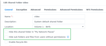

Go to "Control Panel > Shared Folder > select Videos > Edit" then make sure the Hide options are not ticked.
Next click on Permissions and make sure the expected users and groups have read/write permissions.
thanks for the reply these boxes are not ticked ! but se the hardcopy ...
what means this exactly, evtl. a backgroung process ?? thx r.
