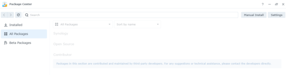

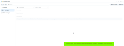

My Internet has been down for 4 days and won't be fixed until tomorrow.
  • On both my Synology NAS running DSM 7.2.2 the widgets panel takes 20 seconds to appear. The DSM webpage appears within 1 second.
  • On my old Synology NAS running DSM 6.2.4 the widgets panel appears within 1 second.
I don't understand why having no internet would affect the widgets panel in DSM 7.2.2 and not in DSM 6.2.4. It is like DSM 7.2.2 is trying to access the Internet before opening the widget panel!?!?

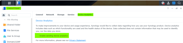

Have you activated support for Synology for the transmission of data? Then I can imagine that it takes so long until a timeout comes back. Otherwise the network traffic would have to be analyzed with Wireshark.
No, I'll boot up the computer in a minute and post a screenshot. 😉
I removed the default gateway from my DS1819+ as a test and restarted it to reproduce your problems. However, the widget panel opens directly on the DS1819+ with DSM 7.2.2 U2.

@maxblank I already have "Send device analytics" disabled on all 3 Synology NAS.
