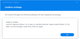

Please try installing Python 3.9 as well. I just noticed in the code that there was a different requirement for aarch64.
(was fixed in v1.4.2)
Perhaps preinst would be a good place to look into this further and inform the aarch64 user.

I've added a test to preinst and preupgrade: synOCR_DSM7_local_BETA_v1.5.99.6.spk
Please try it again (and make sure to install Python version 3.9 or later).
If it works, I'll upload the build to GitHub.

Your python 3 check in preinst and preupgrade looks good. At first I thought why not add python3 as a "install_dep_packages" in the INFO file like install_dep_packages="python>=3.7.0-0" but that won't work because:
  1. Python3 is only required for aarch64.
  2. The various python3 package version have different names: Python3, py3k, python311 etc.
I tried upgrading to the latest beta without python3 installed just to see the message, and it looks good.
With python3 installed synOCR_DSM7_local_BETA_v1.5.99.6.spk works on a Synology with an aarch64 CPU. All 3 files got processed and output to the OUTPUT folder with their modified date pre-pended to their filenames. And the OUTPUT files are a bit smaller than the original files in the BACKUP folder.
