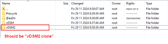

@Berlon
I just cloned vDSM to "vDSM2 clone" and tried to export "vDSM2 clone".
  1. It created a folder named "/volume1/VMM_Export/vDSM2" instead of "/volume1/VMM_Export/vDSM2 clone".
  2. vmm_backup_ova created a backup file but failed to move to "/volume1/VMM_Export/vDSM2 clone".
  3. After it failed it deleted the backup file.
I tried --guests="vDSM2\ clone" and got a jq Invalid escape error.
I tried --guests='vDSM2 clone' and got the same result as --guests="vDSM2 clone".
CONCLUSION:
Synology VMM really should NOT allow people to create a VM name with spaces or fix vmm_backup_ova so it works with VM names with spaces.
I am currently editing /var/packages/Virtualization/target/bin/vmm_backup_ova to fix Synology's mistakes and will report back once I have it working. I'll also inform Synology on how to fix this bug.
