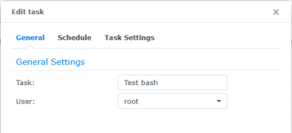

I just realised what would be causing your issue. The mv command cannot remove files that the user running the command does not have permission to delete. You could change the user that runs the scheduled task to admin or root. Thankfully, by default, the mv command retains permissions on the files and folders it moves so running the task as root won't mess up the permissions of the files in Target.
Reaktionen: geimist und dil88
Thanks, changed it. It was executed as "admin", now runs as "root". I will see when I wake up what it has done :)
